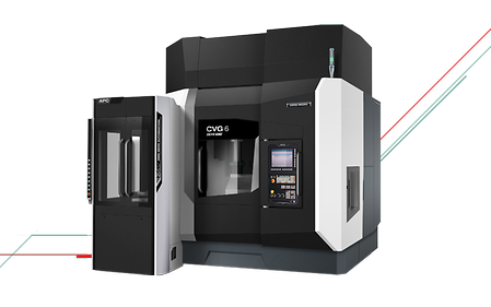

APC by DMG MORI
  • Setup new workpieces in TAIYO KOKI machines during grinding time
  • Fully automated high accuracy grinding incl. measurement
  • Accessibility of all operational areas (work setting, control, machining area and tool magazine)
    from front side of machine
  • Profile grinding of curvic coupling and cam-shapes, etc. (Work spindle direct drive motor spec.) (Option)
  • ATC (6-tool spec.) is equipped as standard
  • HSK-E100 is equipped on internal grinding wheel spindle
Technical data
CVG-6
CVG-9
CVG-13
Maximum workpiece weight
kg4008001600
Maximum workpiece size
mm
Ø650
Ø950
Ø1350
Capacity
Maximum number of stations
pallets
3
2
2
