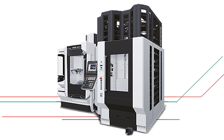

  • Space saving, compact solution by multi layer storage (1,595x2,340mm)
  • Accessibility of all operational areas (work setting, control, machining area and tool magazine) from front side of machine
  • Easy operation using machine controller of machine center to handle automation
