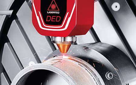

LASERTEC 65 DED Blade
ADDITIVE MANUFACTURING
High-performance additive manufacturing of metallic 3D-parts
  • Laser head integrated in the headstock for higher building volume and more additive performance
  • 5-axis material deposition by coaxial nozzle for homogeneous powder distribution, independent of direction of laser deposition welding
  • Dedicated additive solution for prototypes, small-series, repair and coating
  • Integrated thermal imaging camera for observation of the whole working area, adapive process control and constant monitoring of the working distance
  • Powder feed rate sensor as well as automatic powder calibration.
  • AM Evaluator for visualisation of the relevant process data (e. g. meltpool size, powder mass flow) as a digital 3D-model as well as in the chronological sequence
Siemens NX: Hybride CAD / CAM – Module for additive and subtractive programming
  • One software package for the complete process chain (design, additive machining, substractive machining,  finishing)
  • Exclusive LASERTEC build-up strategies - fully integrated in the CAD / CAM software incl. 3D-simulation of machine and movements for collision prevention
  • Shorter time-to-market due to completete integrated PLM software integration
  • Selectively adding materials with more than 60 Rockwell to avoid heat treatment processes
  • Improving cooling performance by using bronze material in the mould core
  • Better materials and improved reliability in the repair process for increased service life
  • Improved performance of exisitng tool designs by adding wear resistant coating
  • Material gradients between hard and soft, magnetic and non-magnetic, etc.
