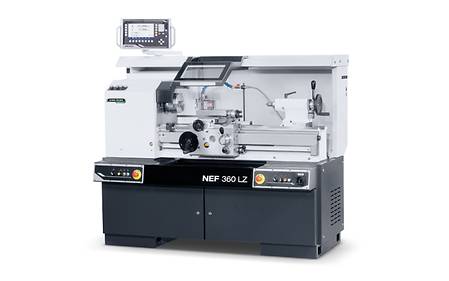

NEF 360 LZ
Ideal for training and conventional manufacturing
Themed image NEF 360 LZ
  • Powerful center lathe in toolmaker accuracy in accordance with DIN 8605
  • Equipment that is universally deployable in any workshop
  • Infinitely variable speed and feed entry via the DMG MORI position display
  • Intuitive operation
  • Main spindle bearing with belt pull relief for highest precision
  • Comprehensive range of safety equipment
  • High-quality apron with drop worm
  • Made in Germany​​​​​​​
Themed image
Technical Data
Workspace
Swing over bed360 mm
Swing over cross slide
195 mm
Distance between centers DIN 806
800 mm
Turning length
800 mm
Width of bed
260 mm
Work spindle
Spindle head DIN 55027 (standard)Size 5
Tool slide
Tool system
Size „B“
Tailstock with hand-wheel
Stroke of quill
110 mm
Diameter of quill
50 mm
Taper DIN 228
MK 3
Drive
Speed range
Up to 4000 rpm
DMG MORI POSITION DISPLAY
  • 17" operating panel with color screen
New at DMG MORI: The center lathe NEF 360 LZ! Due to the comfortable equipment and highest precision it is perfect for training purposes and universally deployable in any workshop.
