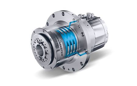

HIGHLIGHTS
  • Proven DMG MORI quality with MASTER spindles
  • Available for all CMX V and U machines
  • 12,000 rpm inlineMASTER spindle with 83 Nm and 13 kW (optional)
  • 15,000 rpm inlineMASTER spindle with 121 Nm and 20 kW (optional)
  • 36-month warranty on all MASTER spindles with unlimited spindle hours
  • Better cutting performance due to 53 % higher spindle power and 45 % higher torque with the 15,000 rpm inlineMASTER (20 kW, 121 Nm at 40 % DC)
Themed image inlineMASTER spindle
  • 25 % faster spindle speed for improved surface quality
  • BIG PLUS® interface for longer tool service life: Elimination of Z-axis movement at high rotational speeds due to face contact
  • Oil / air lubrication of the spindle bearing and improved ribbed structure for long service life
  • Liquid cooling for optimum thermal stability
    DMG MORI components: The new inlineMASTER spindle
