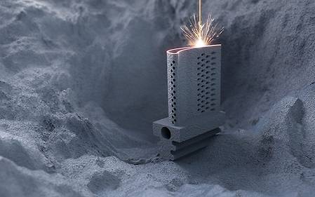

Additive Manufacturing with Selective Laser Melting
LASERTEC SLM - Selective Laser Melting
  • 3D-parts with lattice and honeycomb structures which are not realisable with other machining methods
  • Layer thicknesses between 20 and 100 µm depending on surface quality and building rate
  • Workpieces of various materials with high density and very good mechanical behaviors
  • Holistic software solution from the CAD-file (RDesigner) to the process control (ROperator)
  • Direct post processing done on milling machine of the HSC or DMU series
Additive Manufacturing with a 300 x 300 x 300 mm (X / Y / Z) building volume
  • Application specific laser sources from 400 Watt to 1 Kilowatt depending on application (600 Watt in the standard)
  • Best workpiece quality due to small spot diameter (55 µm) and extreme powder surplus
  • Complete software solution with Rdesignerand ROperator
Integrated powder recycling for even more efficiency and improved powder handling
  • Closed powder loop: Better coating and optimized handling → 24 / 7
  • Powder handling in removable unit for better reliability as well as a fast and contamination free powder change
RDesigner / ROperator for simple and user friendly operation / programming
  • Holistic software architecture with numerous functions, dynamic adaption of the process parameters and integrated nesting
  • Open process parameter database and parameterized process data development.
